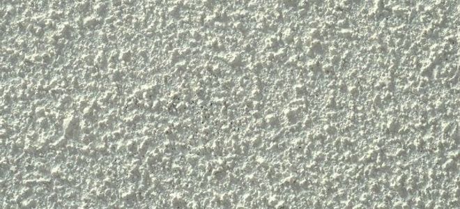

A popcorn ceiling is quick, easy and inexpensive way to finish a ceilng to create in any interior room. They require little maintenance and they last for a long time. However, popcorn ceilings, like any surface, will get dirty. From water spots to light and dark stains, a popcorn ceiling needs to be cleaned from time to time. Here’s a quick how-to list on getting your popcorn ceiling back into tip-top shape.

Take a new spray bottle or a spray bottle that has been completely cleaned and fill it with 100 percent pure bleach. Do not dilute the bleach by adding water because the bleach at pure concentrated levels works best on stains and water spots found on the ceiling. In addition, you want to keep as much moisture away from your popcorn ceiling to prevent water saturation.

Step 5—Add Popcorn Ceiling Cleaning Solution
