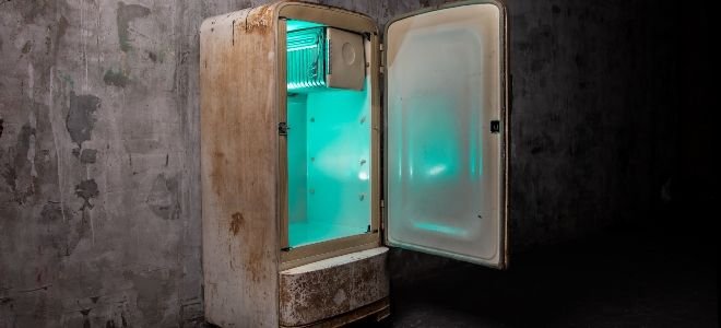

A mechanical problem that keeps a refrigerator from running, or a physical issue like unplanned dents, is no reason to throw out an old fridge when it stops working. Salvage parts from it and turn it into a spare refrigerator for the cabin, garage, or homestead, and keep it from taking up space in a landfill.
If you’ve got the hankering for a challenging project that requires some mechanical and wiring skills, a bit of know how with power tools, and can deliver you some serious street cred when you’re done, this one’s for you. Keep in mind, it might not be the prettiest (or maybe it will be with your creative flair), but who cares? If the 2020s are the decade you've chosen to commit to reducing and reusing because of the climate crisis, by all means, read on!
