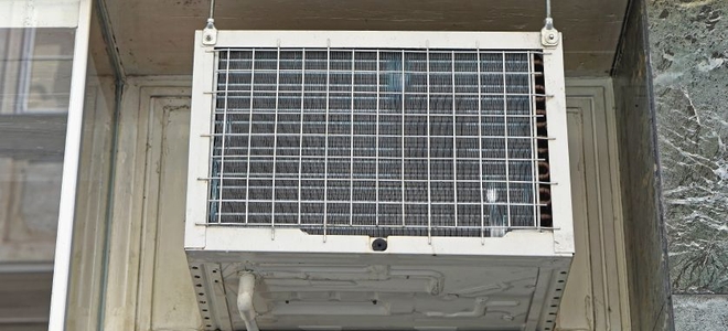

Window air conditioners are so significant during summer because of the hot rays of the sun that can make anyone feel its presence. They save people’s lives, making their life comfortable during hot days. A window air conditioner is smaller in size compared to central air conditioner but functions the same. This piece of equipment keeps running for many hours without interruption each day unless we fail to maintain its good working condition. Though it is just a machine, it can experience power loss, and the reason why is that it needs care and maintenance. A lot of complaints will be heard from people that their window air conditioning unit is not cooling as it used to.  You don’t have to carry your machine or drag it to an expensive repair store without fixing it yourself first. Maybe it only needs some personal cleaning.

With the use of a vacuum having a brush attached on it, vacuum the evaporator coils carefully to get rid of the dirt. Rotate the unit to see the other set of coils which are the appliance’s condenser coils. Eliminate the dirt using a vacuum with a brush comprehensively. With the vacuum and crevice attachment, eradicate the dirt from the fan blades and the insides of the unit.
Step 5 - Check for Bent Parts
Check if there are some fins flattened or twisted on the coils. If there is, then you have to purchase a fin comb in an appliance center and move the comb up and down to make them straight again. Examine if there are any coils that are crooked, then straighten them using the fin comb.
