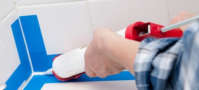

Put the faucets on the tub and then connect them up. Clean the PVC pipe and use Teflon tape on the connections before you tighten them. Don’t overtighten. Now, put the tub drain in place and tighten under the tub. Finish by putting the drain cover in place and tightening it. Turn on the water and open the faucets. This will allow you to check for any leaks in the water lines or the drain connection.
Step 4 - Wall
Apply a small layer of tile adhesive to the wall and put the old tiles back in place as long as they’re will in good condition. After they’ve dried fully, mix up some grout and apply between the tiles, wiping off any excess with a damp cloth.
Once the grout has fully set, complete the installation of the corner bathtub by running a line of silicone caulk between the tub and the wall. Dampen your fingertip and run along the caulk to even it out. Give the caulk ample time to dry. Clean up the bathroom as the drying process continues. Clean the floor thoroughly and put the side on the tub, screwing it in place. When all that is done, run a bath and enjoy your new corner bathtub.
