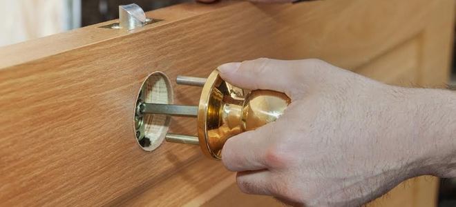

Step 9 - Get the Lockset Measurements
You can use the old door for the lockset measurements, but only if you are using the previous hardware. If you bought a new lockset, use the template as a guide for proper installation.
Step 10 - Paint or Stain the Door
Before you install the new door, take some time to paint or stain it. Do this before you install the lockset. Once the paint is dry, insert the new lockset in place and get ready to hang the door.
