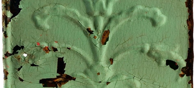

Tin ceiling tiles are a throwback from a time of regal houses, grand hotels and classy movie theaters. Over time, they were replaced by more cost effective materials. If you have tin ceiling tiles in your home, you will notice that they can rust or tarnish. They are no longer mass produced, but they can still be found as reclaimed materials from construction projects. Once you find the new tin ceiling tiles, you need to know how to remove and replace the old ones. The following article will show you how.

Tin ceiling tiles are hammered directly into the ceiling. Removing the old tin ceiling tiles can prove tricky. Inspect the tiles where they overlap as this is where they are nailed in place. Use the putty knife to carefully pry up a side of the tile in order to get a grip on it. Use the pliers to grab the edge and carefully pull it from the ceiling. Repeat this process with the remaining tiles.
