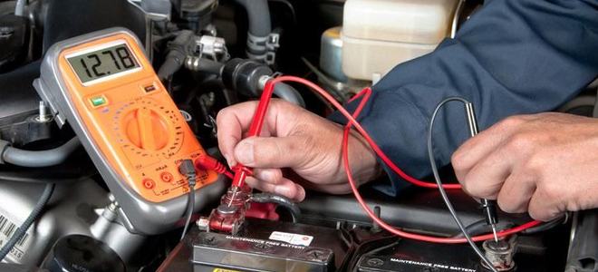

All you have to do now is a quick check of your work. First, make sure that all your cable connections and the battery clamp are nice and tight. Next, try moving the battery back and forth to make sure you don't have a weak electrical connection. Tighten up anything that moves.
Start your engine about a minute after install. If your car starts without any problems and lights are working, all is good. If you have any dim lights or flickering, shut the car off and recheck your battery terminal connections for tightness and corrosion and fix as needed.
