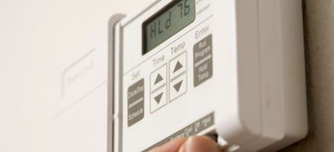

Most homeowners get nervous when they need to know how to replace a thermostat. Working around electricity can make anyone a little anxious if they do not have the know-how to carefully get the job done. Fortunately, replacing your thermostat is a fairly easy task to accomplish.

Remove the old unit by snapping the cover off or unscrewing it if is attached by set screws. Pull the unit away from the wall and slide it off the mounting plate. Be careful not to damage the wires.
