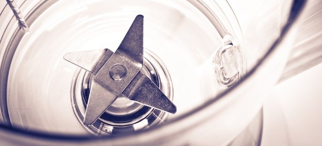

If you have a blender that is old and no longer chopping or pureeing at its best, consider sharpening the blender blades instead of replacing them or buying a new blender. Blender blades are made of metal and can be easily sharpened using the correct method and tools. Below is a quick guide on how to do this and get your appliance back to working as it should.

Step 5 - Sharpen the Blade
Begin running one of the blade edges on a sharpening stone, keeping with and preserving the angle that the blade is already shaped to. Also, always run the blade away from your body to reduce any risk of injury. When you've worked enough on one edge, turn the piece over and proceed to sharpen the other side, moving the same way. Each individual blade will have four sides (two backs and two fronts) that need attention, and each blender usually has two to four blades, depending on the model. Repeat the sharpening process until every edge has been brought to a suitable standard.
