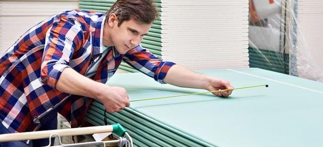

A hand measuring drywall with a measuring tape and pencil.
The most common size of drywall, especially for residential use, is 4 x 8 feet. This size is easiest to handle and hang. However, drywall comes in a range of lengths if longer is needed, and most stores carry sheets from 8-12 feet in length. Choosing which length you want is something that is completely up to the buyer. Using a longer sheet can help keep seams to a minimum and will create a nicer finished product, however, the longer sheets are also much heavier and more cumbersome to handle, especially if you're hanging it by yourself and best avoided in such circumstances.
