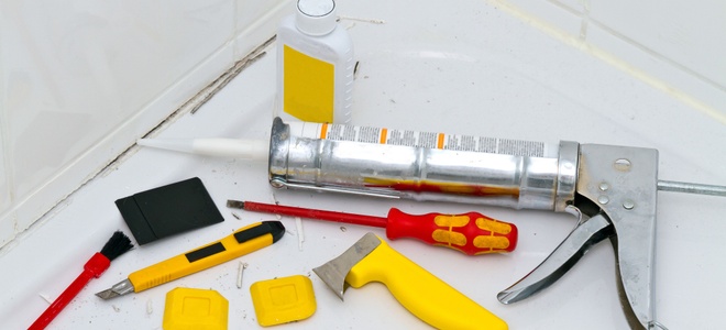

  • Caulking gun

Place the butyl caulk pack into the caulking gun. Before applying the sealant, make sure that the surface does not have any residue or debris. Different particles can affect the application of the sealant.
