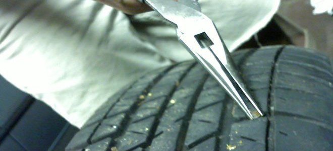

Step 1: Buy a Gauge and Pliers
Make a trip to the automotive parts store and purchase a pressure gauge. This gauge should measure between 0 and 50 psi. Pick up and purchase a pair of pliers. They come in handy when removing the nail or rock from your tire to expose the hole completely.
Step 2: Buy Extra Plugging Strip
Rather than use Fix-a-Flat or a liquid that pushes a soft material into the tire, use plugging strip. Purchase extra plugging strip at the automotive parts store. Plugging strip can be used on any type of flat tire or puncture hole.
Step 3: Remove Object
Remove the object that is responsible for creating the puncture or hole in your tire. It may be a nail, a screw, a rock or any other type of debris left on the roadway. Discard the item in the trash can. (Note: you may need to use your pliers to remove a hard to remove or tightly packed item from the tire)
