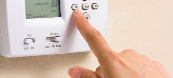

Your furnace thermostat is an essential part of a home furnace system. The thermostat is responsible for regulating the other systems inside the furnace and is primarily in charge of maintaining the temperature at the level that you set. If the thermostat is not working properly, you may find that your home is colder or warmer than you would like it to be. You may also be unpleasantly surprised by your electric bill, as the furnace may be working too much unnecessarily. Read on for a brief but comprehensive guide on how to wire a furnace thermostat.

When you have decided where the thermostat will sit, you can install it in the drywall. Mark the location where you want to install the thermostat. Drill a small hole in the drywall in that area, and then feed the wire into the hole. To install the thermostat itself, use drywall anchors. You'll need to make sure that the thermostat is level, and then use the screwdriver to install the drywall anchors. When those are installed, you can mount the thermostat on the anchors so that it will be supported by the drywall.
Step 3 -- Connect the Wires
Most thermostat systems have 2 wires. One is red, and the other is white. Strip off the casing about a quarter of an inch from both ends of both wires. Install the white wire on the thermostat and the furnace terminals that say "W." Connect the red wire to the thermostat and the furnace at the terminals that are marked "R."
