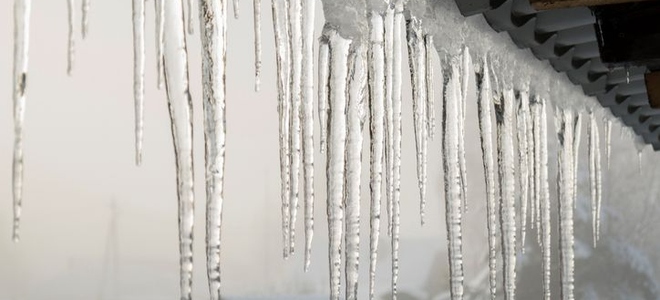

The roofline of a house with snow and icicles on it.
One of the biggest hazards in winter is the formation of ice dams. Ice dams form when the bottom layer of snow on the roof melts and inches down to the gutter and eaves. There, the water accumulates and refreezes, creating a reservoir of frozen liquid. If the dam is big enough, it can cause extensive damage to gutters, shingles, and anything else standing in its way. It can also be a serious health hazards to people walking under the dam, especially if it collapses the structure.
Ice Dam Removal
There are several ways to remove an ice dam before it causes damage to the home. For starters, you can remove the ice chunks by breaking them free in small pieces. Avoid using a sharp tool, however, as you can easily damage shingles. For an easier alternative, fill a pair of pantyhose with calcium chloride and lay it directly on the dam. The chemical will melt away the ice and clear a path for the rest of the water to follow. Never use rock salt on an ice dam as it can cause damage to siding, paint, and plants in the path of the runoff.
Ice Dam Prevention
Ice dams form because of excess snow buildup on rooftops. To avoid ice dams in the future, ensure the roof is properly cleared of snow after each storm. Roof rakes are a great tool for this purpose, though you can also make a DIY snow ripper for the same purpose. Icicles are good indications of ice dams forming, so concentrate on these areas of the home first. Remember, always have safety in mind when removing snow from rooftops. Use appropriate cold weather gear whenever necessary and never stand directly under the roof when scraping away snow.
