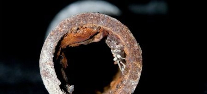

If your piping is galvanized, there is a very good chance the pipes are full of rust and debris from age of the pipe. There is no solution to this other than to replace all the piping to copper, pex or cpvc.
