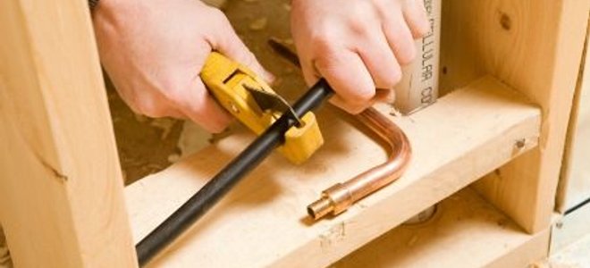

When cutting PEX, it is imperative that it is a straight, burr free cut.  Measure out the length of PEX you will need for installation and cut it with the PEX tubing cutter.  These pliers are especially designed for PEX and should always be used.
When you have the PEX cut to length, slip a copper crimp ring onto the pipe.
Insert the tubing into the piper fitting.  It should bottom out on the shoulder of the fitting. Slide the copper crimp ring up so that it is 1/8" to 1/4" away from the tubing.
Crimp the copper crimp ring with the ring crimper, insuring that the crimper is at a 90 degrees angle from the crimp ring.  Close the crimp tool fully on the crimp ring.
Now, test the crimp with the Go/No-Go gauge. The Go-gauge should slide onto the fitting with ease.  It may be tight where the crimping tool has marked the crimping surface during the crimping operation.  The No-Go gauge must not slide over the fitting.  If it does, the tubing must be recut and the joint made once again.
