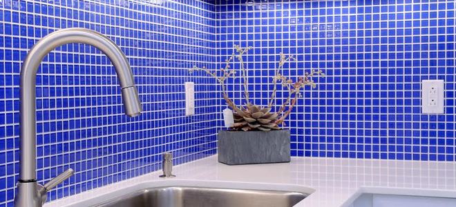

To add some functional elegance to a kitchen you may want to install a pull down kitchen faucet. This type of faucet is a single lever action faucet where you can pull the spout out of the faucet head for washing larger pots, cleaning vegetables or performing other cooking functions. A pull down kitchen faucet brings a contemporary style into your kitchen and modernizes your kitchen sink.
A pull out kitchen faucet can be elaborate or a basic pull out sprayer. It can come in combinations of two faucets (one on top of the other) or a single faucet that is designed to let you pull out the sprayer. Select the type that best fits your needs.
