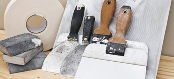

- 8"-10" Drywall Knife
- Adhesive Gun
- Trowel
- Nails
- 1 x 4's & 2 x 4's for T-Brace
- 4" Joint Knife

Step 8: Getting to the Joints: Use a good grade of joint compound to finish all joints, nail heads and corners. In most cases, you'll need two or three coats of compound at all taped joints. The number of coats depends on whether you are using regular drywall tape or drywall tape that has adhesive on the back. If you are using adhesive back tape, center the tape over the joint and press it into place with your knife. Apply two finish coats over the tape. If you are using regular tape, use an embedding coal to bond the tape at each joint (Fig. 9). When the embedding coat has set, apply two finish coats over the tape. Allow each coat of joint compound to dry about 24 hours before applying the next coat.
Step 9: Putting the Finishing Touches On a Drywall Installation: Use a 4" joint finishing knife to smooth out each coat of joint compound. Fill in the slightly recessed area created by the adjoining tapered edges of the wallboards, and smooth it off with the 4" joint finishing knife.
Step 10: Taping It Up: Center the wallboard tape over the joint and press it into place if you are using the adhesive back tape. For the regular tape press it into the first layer of compound firmly, but not too hard. Hold the 4" knife at a 45 degree angle. Press just hard enough to squeeze out some of the compound from under the tape, but be sure you leave enough compound for a good bond.
With adhesive back tape you can apply the fill coat right away. With regular drywall tape, allow the tape to dry in position for at least 24 hours and then apply a fill coat, extending it a few inches beyond the edge of the tape. Feather the edges of the compound for a smooth finish. After the fill coat has dried, use a 10" joint finishing knife to apply still another coat of joint compound. Feather this coat about 1 1/2" beyond the edge of the first coat.
