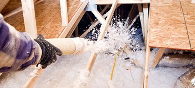

Measure and Place Holes Correctly
In order to successfully install blown in insulation, you will need to cut a hole in your outer or inner wall, depending on your particular plan. This step must be done very precisely, as there are many things that can go wrong with it.
First, you will need to know about the specific insulation blower that you will be using. In particular, you will need to know the width of its nozzle. Try to find this out in advance, but if you cannot, it is fine to simply wait until you have access to it and measure the nozzle with a tape measure to determine its width.
Now that you know how wide your blower's nozzle is, you know how wide to make your holes. Your holes must be slightly larger than your blower's nozzle, but with as small of a difference as possible, as a large empty space can send insulation materials everywhere when you want them to fall neatly into your wall. When installing your insulation, cover the gap with a rag.
In addition, place the holes as high as possible to avoid blocking the nozzle as the material falls.
