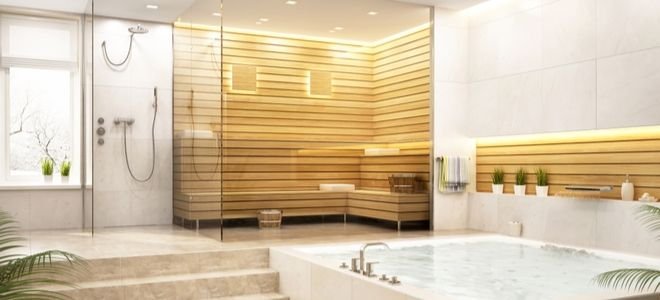

Installing Frameless Shower Doors In Your Bathroom
by DoItYourself Staff
Frameless shower doors are a good option for stand alone showers. Frameless shower doors are made of heavy glass that gives the bathroom an impression of being much larger. These types of doors are very easy to clean and have a watertight seal that keeps the shower water inside the shower. Installation is an easy process and can be done within a few hours.
