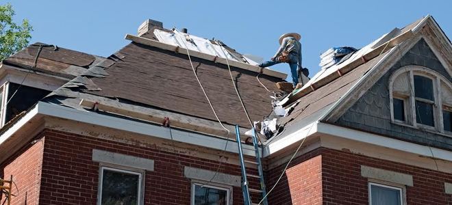

Step 1 - Safety
The most important thing when working on any roof is safety. It's essential that you set up ladders and/or scaffolding to access the roof. Take the necessary precautions to make sure that you won't put yourself at any unnecessary risk.
