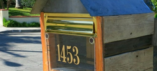

I cut a rectangle of Plexiglas about an inch larger all around than the opening below the mail slot. On the inside surface, I used Gorilla Glue to secure a magnet in each of the upper corners and 2 brass hinges along the bottom edge.
instant curb appeal, make a new mailbox, Justin DiPego
I wasn’t happy with the strength of the bond on the hinges (it’s possible I didn’t let it setup long enough), so I also shot screws through the plexi side of the hinges. I screwed the hinges to the bottom edge of the mailbox opening, and drove a screw into each side of the frame, opposite to the magnets.
instant curb appeal, make a new mailbox, Justin DiPego, dog
Finally, I put the address on the door with number stickers.

Your mailbox is done.
