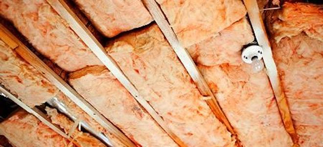

  • Working on your knees in a hot attic for long periods of time can be very tiring. Plan this phase to take a few breaks in your work time. Try to work early in the morning before it gets too hot. You will be covered from head to toe in clothing and gear. It may help to add a spray container of cold water to your tool box to spray on yourself and your fogged up goggles.
  • Again using the steel tape measure, measure the length of the space and cut the fiberglass batting with a very sharp utility knife. Cut each piece an inch or two longer than needed to assure a snug fit. Use a straight edge to assure a good straight cut across the fiberglass batt.
  • Staple it to the rafters or scabbed on boards with a staple gun so that the paper backing is toward the interior of the room to act as a vapor barrier. Use 3/8" heavy duty staples every six inches. Attach it by the paper flange so as not to compress the fiberglass. Make sure the paper flange and the staples are flat against the board to create an even surface for attaching the finished wall material.
  • Where the spacing of the rafters is uneven, odd angled or not standard, you will need to cut the insulation to fit. Cut it one inch wider then the necessary width and tuck the fiberglass in to create a flange for stapling.
  • Once the insulation is in place between all of the rafters, we recommend you staple up a vapor barrier of 6 mil polypropylene (a painter's drop cloth) along the face of the rafters. Although the paper or foil backing of the insulation is a vapor barrier, the added polypropylene covers completely. This assures no moisture will form in the cavity. As you staple the vapor barrier to the rafters, draw it as airtight as possible. But be careful not to puncture the plastic unnecessarily as you put it in place. Should this occur, repair it with duct tape.
  • When installing insulation over wires, pipes or fire blocking, back cut the batt to fit over the obstacle leaving the paper intact and the insulation uncompressed.
