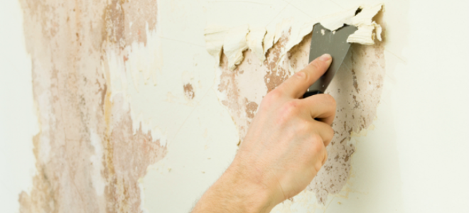

Vinyl Wallpaper
If the original wallpaper is a non-porous vinyl, neither the steam nor the chemical stripper will easily penetrate. In this case, you may have to rip the vinyl face from the wall before using steam or the chemical remover.
If you find that the vinyl wall covering is difficult to pull off, even after using the steam or chemical method, you can make small perforations in it. This will allow the steam or chemical to pass through the perforations. There are two ways to accomplish this. One way is to use a Paper Tiger. By rolling this tool over the wall it will make pin-like perforations in the paper, leaving the wall underneath undamaged.
Remove the Residue
After the paper is removed you will need to also remove the residue paste that is left. You can do this by using hot water and a wall washing detergent, using the wallpaper stripping chemical as a final wash. If there is an excessive amount of paste left on the wall, you may need to re-spray the walls with the chemical stripper. Then, use a scraper or putty knife to remove the residual glue, followed by a final rinse with a sponge dipped in the stripper.
