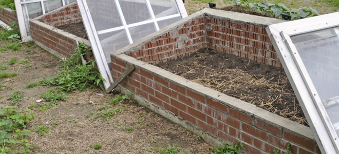

Building the Cold Frame
The top of most cold frames made at home are old window sashes. The panes of glass let the sunshine in. The dimensions of the frame depend on the size of the window you use. You will need to hinge the window, so purchase heavy duty hinges. An extremely simple cold frame is nothing more than cement blocks lined up to hold a window on top.
If you opt for a wood frame, make sure the wood will not decompose. Cypress or cedar are good choices for the wood frame. Keep one thing in mind as you build your cold frame: do not make it so wide that you cannot easily reach the plants at the back, especially if you're growing vegetables in the cold frame. Three to four feet is the maximum width for most people to reach the back for weeding or harvesting.
Build the frame to fit the windows, higher in the back than in the front. Add weights to keep the window sashes from blowing open during strong winter storms. You'll also want to include a way to keep the window open for ventilation during warm days when the temperature reaches above 45 degrees. A prop comes in handy for this purpose.
