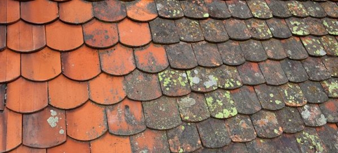

Housetops are often left unnoticed. That is, until there is a problem. Because of their location, they're often an afterthought, however, roofs can quickly become unsightly or damaged if they are not checked regularly for problems. One issue that can lead to roof damage is black streaking caused by algae.
Caused by tiny organisms that get their food from minerals in the shingles, algae create unattractive streaks and stains. While these stains may not cause actual damage to shingles, they do leave a home looking less than appealing. A combination of bleach and water can be used to scrub the algae from the shingles. Once the stains are gone, the shingles will then need to be rinsed with clean water to prevent any damage from bleach residue.
Causes of Black Streaking on Roofs
Black streaking on roofs is a common problem. While the streaks do not cause a great deal of damage, they can cause the shingle to age prematurely. The streaks are caused by a type of algae known as Gloeocapsa magma. Over time this algae accumulates, developing a black outer coating which causes stains on roof shingles. The algae feed off of the limestone within the roof shingles. With each passing year the algae will grow and become more and more noticeable. As it grows, it will also trap moisture in the shingles, causing them to age sooner than they should.
