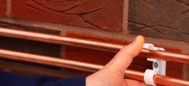

Secure Plumbing
Make sure that the plumbing pipes are mounted securely and wrapped with pipe strapping to fix them firmly in place. If pipes shake easily when water flows through them it means that they are not secured properly.
