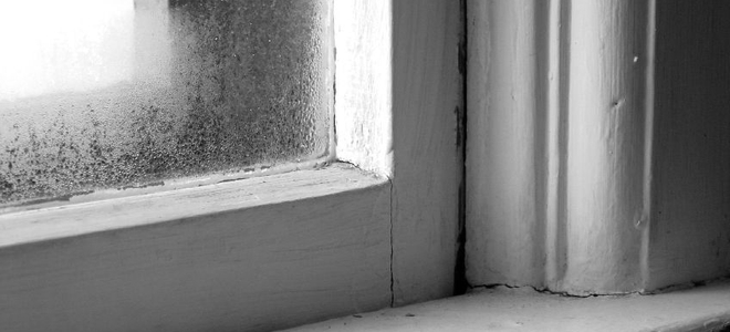

There is always some moisture in the air around us. An indoor relative humidity of about 50 percent is usually considered a healthy level because it is comfortable for humans and because many molds and mites are unlikely to thrive in that environment.
When is Moisture a Problem?
Even though you need some moisture in the air you breathe, too much moisture in your home can cause problems. When moist airtouches a cold surface, some of the moisture may leave the air and become liquid, or condense. If this happens on a cold pane of window glass, you will see the water run down and collect on the window sill, where it may ruin the paint or rot the wood trim. The water may even freeze, producing frost on the inside surface of the window. If moisture condenses inside a wall, or in your attic, you will not be able to see the water, but it can cause a number of problems. For example, mold and mildew grow in moist areas, causing allergic reactions and damaging buildings. Structural wood may rot and drywall can swell. If moisture gets into your insulation, the insulation will not work as well as it should, and your heating and cooling bills will increase.
