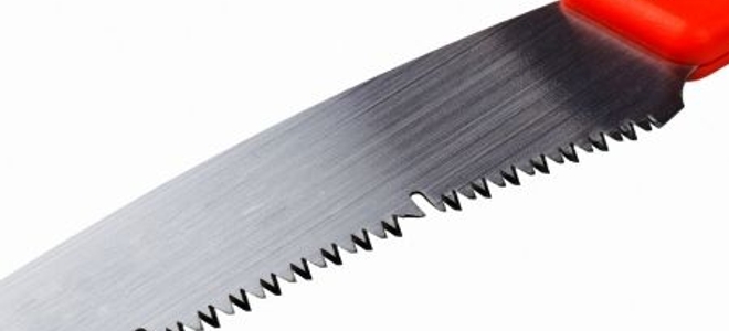

For branches too large to be cut with a hand pruner or lopping shears, pruning saws must be used. Pruning saws differ greatly in handle styles, the length and shape of the blade, and the layout and type of teeth. Most have tempered metal blades that retain their sharpness for many pruning cuts. Unlike most other saws, pruning saws are often designed to cut on the "pull-stroke."

To ensure that satisfactory cuts are made and to reduce fatigue, keep your pruning tools sharp and in good working condition. Hand pruners, lopping shears, and pole pruners should be periodically sharpened with a sharpening stone. Replacement blades are available for many styles. Pruning saws should be professionally sharpened or periodically replaced. To reduce cost, many styles have replaceable blades.
