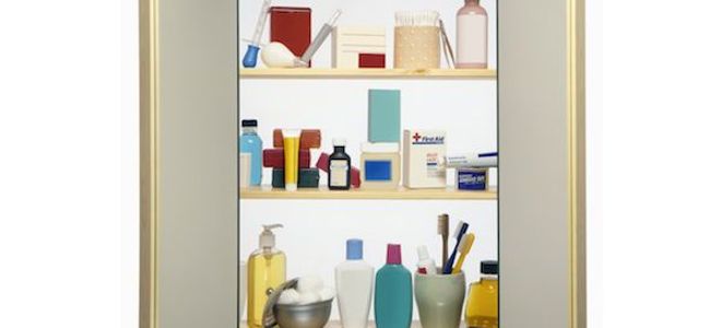

A recessed bathroom medicine cabinet will add much-needed storage space to a small bathroom. Follow these installation steps for a project you can complete in an afternoon.

7. Insert Cabinet
Once your frame is in place, you can slide the medicine cabinet in to place. Level the cabinet to make sure it's even, and open and close the doors to ensure they have enough room to operate properly.
