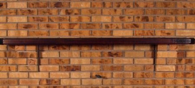

Measure the dimensions of the skeleton or the existing mantel. You're going to build a new skin for it. Use poplar lumber. It's easier to work with than harder woods like oak that accepts paint or stain well and maintains straight and sharp lines better than softer woods like pine or fir.
Use one-inch boards. The width depends on the dimensions you want in the end. Either 1x6s, 1x8s or 1x12s should work. If you want to put anything large (like a TV) on the mantel, the top should be a 1x8 or 1x12. Cut the lumber to the length of the top, the front the bottom and the sides.
Step 4 - Rebuild Your Mantel
Instead of wholly replacing your fireplace mantel, reuse it. Build a wood frame that will slide right over the old mantel. Essentially, you need to build a long, thin three-sided box. Either assemble the box with finish nails and slide it over the old mantel, or set the pieces in place one at a time and nail them in place. Either way, use glue on the underside of the boards and on the surface of the old mantel.
If you're rehabing a brick mantel, use construction adhesive and drill pilot holes through the wood and brick, and screw the skin in place with masonry screws.
Countersink the screws or nails, so they're a little below the surface of the wood, and you can hide them with wood putty. With the rebuilt mantel attached to the fireplace, test that it’s set firmly in place.
You can embellish it with molding, or leave it plain for a more spartan look, depending on the surrounding decor.
