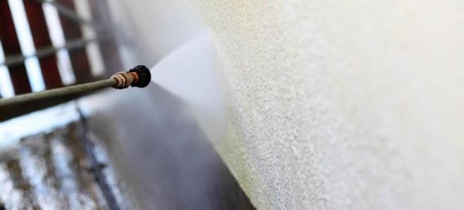

Remove the spray attachment from your garden hose and attach the power washer in its place. Connect the power washer cord to an electrical outlet. If necessary, use an extension cord to reach all sections of the walls with mold stains. Be sure to use an extension cord that is certified for outside use with a power washer device.
Turn on the water tap connected to your garden hose. Make sure the water is flowing at full force. Turn on the power washer. Point the end of the power washer away from the house and from any pets or people. Gently squeeze the wand trigger to ensure that it is working properly. Point the sprayer toward the stucco wall, beginning at the area closest to the roof. Move the sprayer in a horizontal motion across the wall. Slowly spray the wall from the top to the bottom. Stop in difficult areas and apply extra time on these spots. Once all of the mold stains have been removed from the stucco, allow the exterior wall surfaces to dry completely. This should take about 24 hours.
