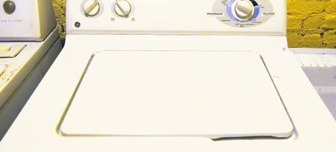

Washing machines are taken for granted in most households. If someone had to name which appliance loss would hurt them the most, the majority would say their oven. But if the oven goes, you still have the microwave oven. If the dryer goes, you can still hang the clothes on the line. But if the washer goes, we're back to caveman times, banging clothes on rocks. Well, maybe not so dramatic, but the washing machine has indeed become a necessity for convenience's sake.
Today we're going to go over some of the more common problems that many people face with their washing machines. Hopefully, if you're in a dilemma, this article will help you out of it. Take a minute and read our article on how washing machines work before we get started. It will give you a better idea of where everything is and how it works.
As always, an important rule is to turn the power OFF before troubleshooting unless otherwise noted. Another tip is to keep a notebook nearby so when you remove wires, you can write down the "what goes where" details - you'll thank yourself later. The testing of some parts may require a VOM (volt-ohm meter), which can be picked up at most hardware stores.
Problem: The washing machine won't run at all.
Solution: Make sure it is plugged in. If it is, then check the outlet with the VOM for voltage. Check the power cord for any damage. If they're all satisfactory, then here's a run through of potential causes:
