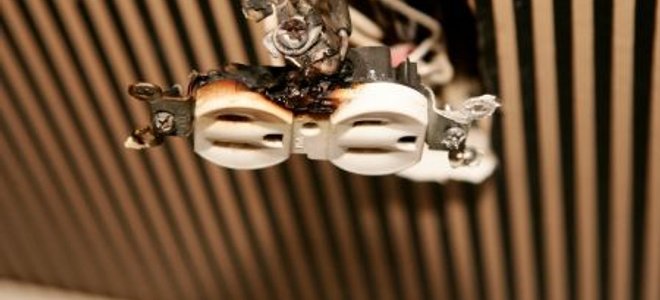

Every year, thousands of homes catch fire, hundreds of lives are lost and millions of dollars are spent rebuilding burned out homes. In many cases, it's older wiring that's the culprit. But there are also occasions when a bad or broken outlet shoulders the blame. This article will go over some of the signs to look for if you think you may have a bad outlet and how to easily replace it so you don't become a victim of an electrical fire.

There are a few simple things to look for when trying to determine if you have a bad or broken outlet. The first thing, of course, is external evidence that the outlet may be broken. The face of the outlet is made from plastic, so over time it can crack or chip. Also, if the outlet looks burned or has what looks like scorch marks above the outlet, then you know it's time to change it.
