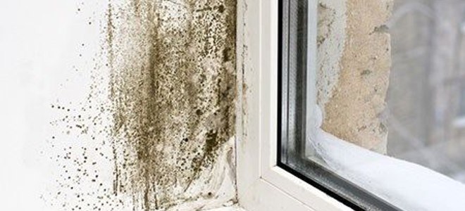

Visible mildew/mold, is easy to identify because of its discoloration and odor. There are products on the market, usually containing chlorine bleach, which can kill molds. Keeping humidity in a home low can help keep visible mildew from returning. But when mold spores get into the air conditioning system, they can settle in the air conditioning ductwork along with dust and other contaminants. Air conditioning duct systems, especially in humid climates, can be virtual incubators for microbial pollutants such as mold and bacteria. With the alternating high and low humidity conditions which regularly occur in air conditioning ducts during air conditioner operation, molds will grow, spread, produce spores and distribute the spores throughout a house. Mold contamination in air conditioning ducts poses a serious problem.
