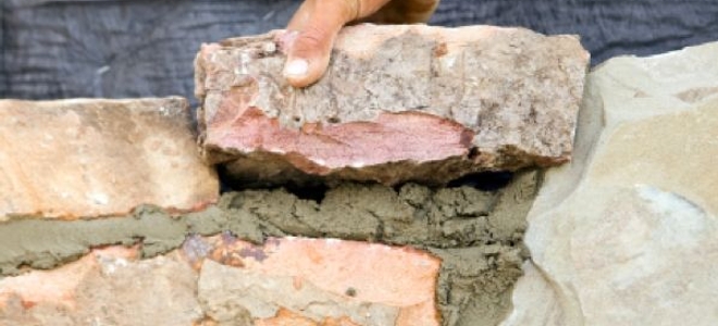

Loose Stones
If there are any loose stones in the foundation, carefully slide them out from the hole in preparation for repairs. It's a good idea to leave them close to where they are from because you don't want to have to worry about doing a huge jigsaw and figuring out where all the stones go. A wire brush can be used to brush away any debris from inside the holes and on top of the individual stones. Use some water to clean the entire hole.
Removing Old Mortar
The old mortar needs to be removed by using a chisel and a hammer. Go about this carefully so that you don't cause any further damage to the wall. Carefully chip away at the mortar and start scraping it out. The old mortar should come out very easily if it is already cracked or damaged.
At a crack, remove the mortar around the crack with the chisel and hammer, creating a path 1/2 inch wide along the visible length of the crack.
Mixing Mortar
Once you've prepared the wall you will need to mix a new batch of mortar. To do this follow the instructions on the packet to create a strong mix. Put the mortar into the gaps which you have just chipped out and also around the holes where you have taken the missing stones from. Apply a layer of mortar to the loose stones and then slide them back into the hole. A trowel can then be used on both sides to remove any extra mortar.
If there are any small stones which have been removed from the wall then this whole section can be filled using mortar if desired. To do this use the flat edge of your trowel to ensure that it's level with the wall.
