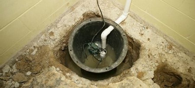

Hidden in the deepest corner of your basement, your sump pump is mostly invisible, but could be the most important appliance in your house. The sump pump removes ground water from underneath your house. Without it, water coming up from the ground, or flowing in from a heavy rain can flood your basement or your whole house. The pump usually sits in a pit built into your basement floor or crawlspace. The concrete floor is poured slightly downhill when the house is built so that any liquid will flow right into that pit. The sump pump ejects the water out of the house.
The pump sits in the bottom of the sump hole and has a switch that is activated by the water level. When you have water in your basement, it flows into the pit, the pump is activated and it pumps the water out of the pit through a discharge pipe to the outside.
