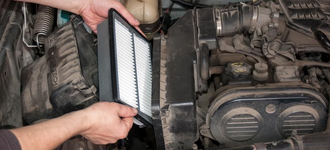

Replace a Dirty Air Filter
You should replace your air filter once a year or every 12,000 miles. A mechanic will usually charge you extra for this simple job, which takes less than 10 minutes to complete. Simply locate the air filter under the hood, which is typically housed in a rectangular plastic box. Remember how the old one is situated and place the new one the same way. Close the box firmly and throw away the old filter.
