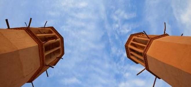

These ventilating structures rising above the house let the wind draw up the air inside, creating a constant air current through the house. Sometimes they are connected to a deep well in the ground so that cooler air circulated.
