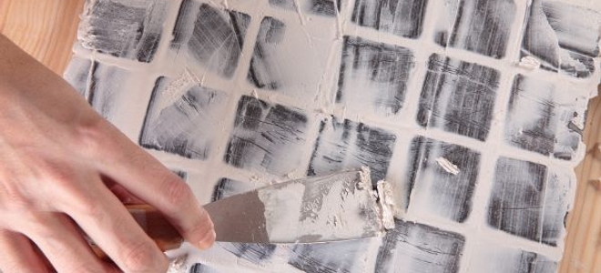

The easiest way to apply grout is with a rubber-faced float or a squeegee, although you can do it with your finger and a large sponge. An old toothbrush is handy too to help work the grout into the joints.
It is best to mix the tile with a 50/50 mixture of water and grout fortifier. It will make a more watertight seal.
The following are the steps in applying grout:
  1. Apply grout to the surface of the tile, spreading it with the float or squeegee and forcing it into the joints. It is critical that the joints be completely filled so that there are no bubbles or gaps.
  2. Scrape the excess grout off by wiping diagonally across the tiles with your float or squeegee.
  3. With a cleaned out sponge washed out in clear water and wipe away any remaining grout. Wipe the grout away as you go. Grout an area, then wipe it down. Don't wait until you've grouted the entire area. Continue to rinse and wring out the sponge until the joints are smooth and level with the tiles.
  4. Let the tiles dry out. After about 30 minutes a hazy grout film will appear. Wipe that away with a soft cloth. You can use the end of a toothbrush handle to tool the joints and clean the intersections.
