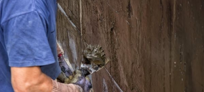

Waterproofing basement walls is a very important task that you need to take care of even if there is no actual problem. One of the most effective waterproofing materials is the crystalline capillary known also as CWM. It is a material used in concrete sidings and walls because it can penetrate it and change its basis, making it water impenetrable. CWM is ideal for waterproofing basement walls to prevent leaks and seepage and to deal with existing water issues. However, before applying it you should be aware of certain tips, in order to avoid mistakes associated with its use.
Preparation
Concrete walls need to be thoroughly prepared for the application of the CWM. You should not omit this because scraping off the concrete and older paint is an essential part of the waterproofing basement process. Repairs are also necessary; if there are holes and cracks you need to clean them and fill them, removing possible debris as well.
Watering the Walls
One of the common mistakes most people do is that they do not water the walls; most people think that since they apply a waterproofing material, they should keep the walls dry upon application. This is wrong because this particular type of material forms a thick paste when mixed with water. The CWM heats up and then forms this pliable paste which becomes an effective waterproofing coating. In fact, you are supposed to water the coating for 48 hours, to be able to penetrate the walls more effectively.
Crystalline waterproofing material is a very effective material if you follow the instructions of the manufacturer as closely as possible.
