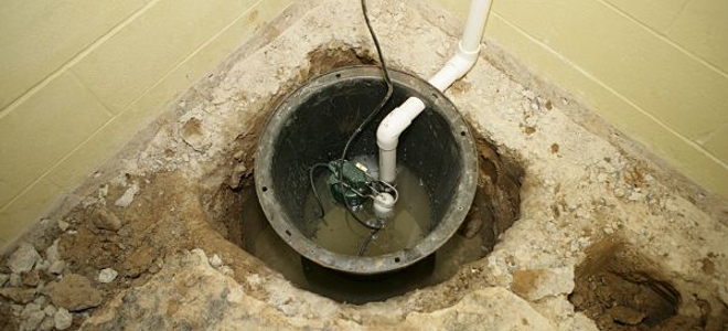

A pedestal sump pump is a pump that removes excess water out of a basement and drains it into a drainage supply to prevent flooding. Once the water reaches a certain height, the pump activates and pulls the water out of the basement. If you live in an area that experiences high rainfall, or you have a basement that is prone to flooding, installing a pedestal pump is simple and will save you quite a bit of money in flood damage control.
Purchasing the Pedestal Sump Pump
There are several types of sump pumps available. A pedestal pump can have more benefits, depending on your needs. A pedestal tends to be noisier, but it costs far less than other types. Along with the purchase of the pump you will need to purchase a sump liner as well. The pumps are available in different pumping capacity. This is measured by the gallons per hour the pump is able to discharge. To find what size pump you need you will need to take measurements of your basement.
Where to Install the Sump Pump
Before installation you will need to locate the sewer, water, and other utility lines that run through and under your home. You will need to dig in to the floor of the basement to install a sump pump, and having these lines marked will prevent you from breaking through any lines. The pump will need to be located near electrical outlets, and preferably on an exterior wall. The outlet will need to be a GFCI protected circuit to prevent any circuits from blowing. If the pump can not be placed near an existing outlet, an electrician can easily install a new one for you.
Discharge Pipe
Excess water from your basement will get pumped out and drained in to a discharge pipe. The discharge pipe will carry the water outside the home. This pipe attaches directly to the sump pump. It will need to be routed from the basement to your yard, and away from your house.
Digging for the Sump Pump
When you start the process of digging for your sump pump, you will need to use a jackhammer to break through the concrete floor. Make sure you use eye protection, and you follow the directions for the jackhammer to prevent blowing any fuses or circuits. Depending on the pump you choose, the depth of the hole will vary. The manufacturer’s directions will provide you with a recommended depth for the liner. The liner is sealed with concrete to keep it secure.
Installation
Once your hole is dug, and the liner is placed, you can start to install the pump itself. The pump needs to be attached to the discharge pipe. The pipe will need to be cemented in to place. A diverter on the pipe will help to ensure the water flows away from your home and not towards it. The directions provided with the pump will explain how to install the pump in the liner, install any float valves and anything else you may need.
