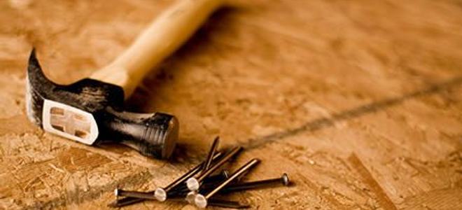

Hammers
Hammer tips and tricks The carpenter's hammer is available in two patterns.
The claw hammer is made with a curved claw, better suited to pulling nails.
But for those who will also be ripping boards out, the ripping hammer with its straight claw will more easily fit between boards. Both are used to drive or remove nails. They come with wood (usually hickory), steel or fiberglass handles and in a variety of face styles and weights.
A 12 to 16 oz. finishing hammer is recommended for small workshop projects and general use, and 18 to 24 oz. hammers for heavier framing work. Finishing hammers are those with smooth faces.
