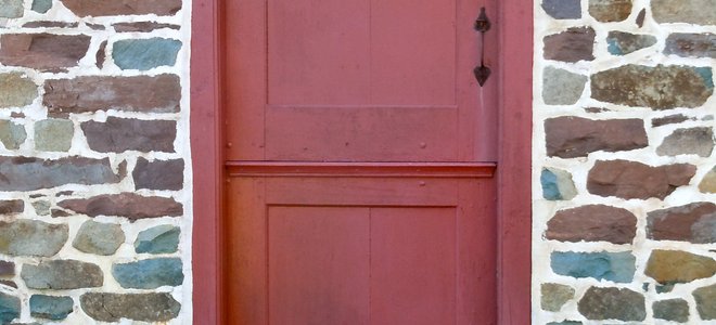

A dutch door is an unusual and attractive option for an exterior door. This unique addition will serve functional purposes as well as provide a decorative touch to your home.
You can create this split door from an existing exterior door in your home, creating your own unique, decorative look. This project works best with a solid wood exterior door, particularly one with a four-panel design.
This task does require advanced woodworking skills, but can produce a charming and decorative result.

Cut the Door
Remove the door from the hinges again. Lay it across the sawhorses. Decide where you want to make the cut; often on the center rail of a solid wood door, but not necessarily.
Using a straightedge, carefully measure a straight line across the door, then draw another 1/4” away. You will need 4 sawhorses all together as you cut on each of these lines with a circular saw. This ¼ inch will allow the door top and bottom to swing freely.
