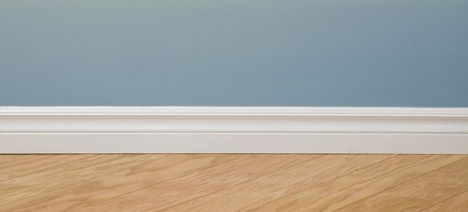

Baseboard Molding
This trim product hides the connection between the wall and the floor. The bottom of this type of trim is usually wider than the top. This design feature creates protection against anything that may come in contact with the wall such as a vacuum, a broom or any other type of cleaning tool.
