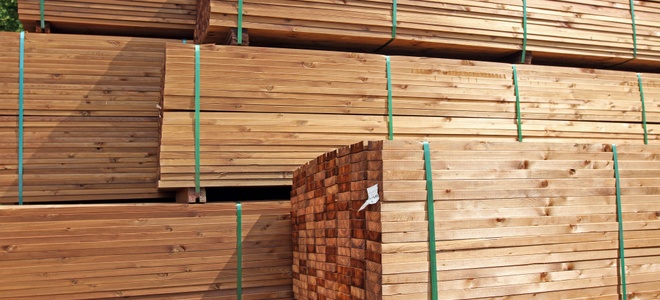

Understanding Basic Types of Lumber
Western Lumber
  • Known for its ease of workmanship and nailing as well as strength and dimensional stability.
  • Western lumber includes more than 15 commercially important Western softwood species.
  • Most common species are Douglas fir and Hem-fir.
  • Can be classified as High Quality Appearance, General Purpose Board or Radius-Edged Patio Decking Grade.
  • The Western Wood Products Association (WWPA) has a rigorous inspection and quality control process. Lumber with the WWPA logo indicates the lumber has passed that quality control process.
  • Lumber with only the “WWPA Rules” stamp indicates the lumber has been graded according to the WWPA rules, but not been inspected by WWPA.
    Redwood
  • Most redwood sold is heartwood and sapwood grade. Each type comes in several grades, from a fine finish appearance to a rougher, less attractive finish.
  • Heartwood contains natural barriers to termites and decay and is suited for applications that come into contact with the ground.
  • Sapwood contains cream-colored streaks. It should not be used in contact with the ground.
  • Architectural redwood is the strongest redwood. It is normally kiln-dried and used for structural and finish applications.
  • Garden redwood comprises lower grades that are not kiln-dried and are commonly used for decks, fences and other outdoor garden uses.
    Southern Pine
  • Has high strength, resistance to wear and holds fasteners well. It is often used in homes and other structures.
  • Descriptions for this type of wood range from 1 through 4.
  • No. 1 has the highest quality and best appearance.
  • No. 2 is characterized by tight knots and is generally free of holes.
  • No. 3 is good, serviceable sheathing, usable for many applications without waste.
  • No. 4 contains usable portions at least 24” long.
    Treated Lumber
  • Lumber treated to resist weather, termites and fungus.
  • Treatment involves chemical preservatives forced deep into the cells in the wood under pressure.
  • Wood used for decks and other outdoor consumer use is generally treated with an inorganic chemical. In 2004, the EPA outlawed the use of arsenic as a method of treating wood. ACQ and copper azole are the current popular chemicals used.
  • Treated wood still absorbs water, and the treatment is not considered waterproof, but rather decay-proof.
  • Wood species typically used include Ponderosa pine, Lodgepole pine, Douglas fir, Hem-fir and Southern yellow pine.
  • Remind customers to wear respiratory protection when cutting treated lumber.
    Pine Shelving
  • Lumber 1” thick and of varying widths and lengths.
  • Most consumer inventories range from 1” x 1” to 1” x 12”, up to 12’ long.
  • From 1” x 1” to 1” x 6”, increments increase by 1”. Then, lengths increase in 2” increments from 1” x 8” to 1” x 10” and 1” x 12”.
  • Most consumer sales will be in 4’ and 6’ lengths.
  • No. 4 grade pine is commonly called “garage shelving”. Many consumers use it for basements and garages where looks are not important.
