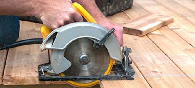

Saw Accessories Safety Tips
  • Always wear safety glasses and ear protection when using a saw.
  • Only use an abrasive blade if you also have an aluminum or magnesium guard for protection.
  • Always make sure you are using the proper blade for the material you are cutting.
  • Beware of kickback of a circular saw, which is when the blade becomes pinched and the saw lifts up out of the workpiece and toward the user. To prevent it, make sure the blade is sharp and clean, do not overheat, support large panels so they will not pinch the blade, beware of knots or sap in the wood and never remove the blade from the material while it is cutting. Release the switch immediately if the saw stalls or binds.
  • A self-retracting guard that closes over the blade as it cuts is a good safety feature on portable saws.
    Carbide-Tipped Saw Blade
  • Circular blade used for working with plywood or hardwood.
  • Lasts up to 10 times longer than regular blades.
  • circular blade used for working with plywood or hardwood.
    Combination Blade
  • Most commonly used circular blade.
  • Used for cross-cutting, ripping and mitering in hardwood, softwood, veneer and plywood.
  • Does not leave a smooth finish.
