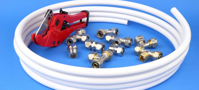

Since, PEX is flexible and comes on a large roll, it can be threaded through holes cut in the framing of a house (similar to copper wire) without requiring any elbow joints or couplers that all need to be soldered and can leak over time. As there is no need to solder multiple joints, PEX can be installed much quicker than traditional copper, and that time saving translates directly into money saving. It requires only a PEX crimping tool and adapters to connect runs, and adaptors are available to connect PEX with copper and other hard plastic pipes. That makes it a good choice when expanding or upgrading existing plumbing in a home and ideal for a DIY'er who isn't comfortable sweat soldering copper joints.
