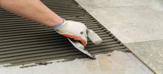

Not everyone realizes how many tools are required for a project. A tape measure and level are somewhat obvious tools you will need, but don’t forget a chalk line for marking the layout and spacers that will leave room for grout. A notched trowel is used for the adhesive, grout float for the grout, and a sponge for cleanup.

A man laying tile on a floor.
There are two ways to approach the actual tiling process: starting in the middle or in a generally hidden area of the room. While it is easy to start in a corner, you will get a more symmetrical look by starting in the middle. This will prevent you from having disproportionate sizes on each end of the room. It can also be a good idea to start in an area that will be hidden, or that is not drawing in the eye. Think about it: you always get better further into your work, so by starting somewhere less visible, the areas that are in the spotlight will look the best.
The spacers will also make it easy to do a practice row before you use the adhesive. You can also use this to practice and better visualize the layout before actually starting your floor tile project.
