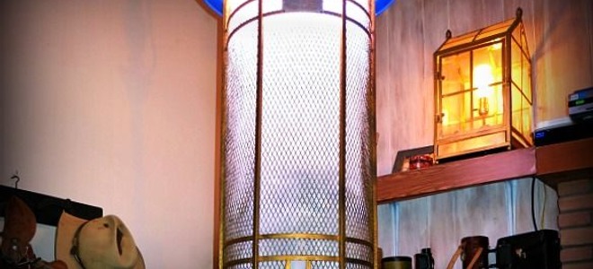

The empty base had plenty of room for a stereo that features a CD player, Bluetooth and USB. There’s space for a turntable too, but I’m not hip enough to have a vinyl collection. I ran the speaker wires through the wooden ring and unto the cylinder and stacked two speakers behind the plastic curtain. I attached a bracket to the top speaker and installed two LED bulbs. One bulb is just an area light and it operates with my smart house system. The other light comes on when the music plays and pulses in colors to the beat.

Now that it was all together it was too majestic to keep calling it an upcycled heater, and jukebox may or may not even be technically correct. This creation was unique and it needed a name befitting its appearance and function.
What We’re Working On, My Upcycled Patio Heater Juke Box, Audiopticon, Justin DiPego
Rising out of the rust and ashes, I give you, “the Audiopticon.”
